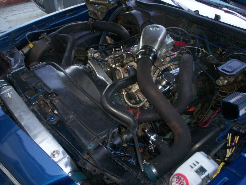

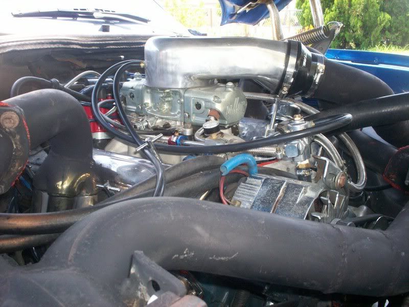

It's the na one. I modded it myself. I added jet extensions, drilled out the pvcrs, added vent tube extensions, removed the power valve blow out protector, and that was about it.I recently made a homemade boost referenced power vavle that I still need to install

did you build the carb , or buy an off the shelf unit? I know BG makes some blow through carbs.

I've read that the bg blowthroughs still need to get messed with to get right. I did all the tuning myself.

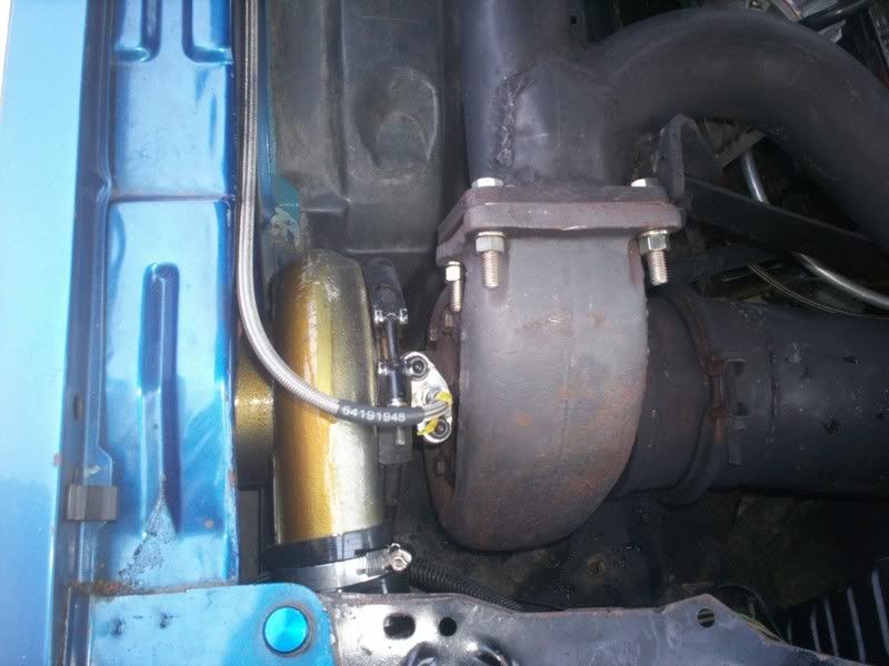

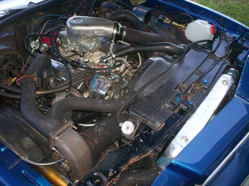

They worked out great for me except that I had the tall valve covers. I had to do some massaging with a hammer to the top of the valve covers to fit the headers. If I need to take off the valve covers, I have to remove the headers also. I did chop off the 3 bolt flanges to weld the tubing to the turbo and then used the chopped off flanges further down closer to the turbo. The headers were cheap ebay ones and they had 1 5/8 primaries. You might be able to fit the headers with regular short valve covers.

The flanges were lower than the carb, but if your thinking of mounting the turbo on the flanges, you will have to cut a hole in your hood.
