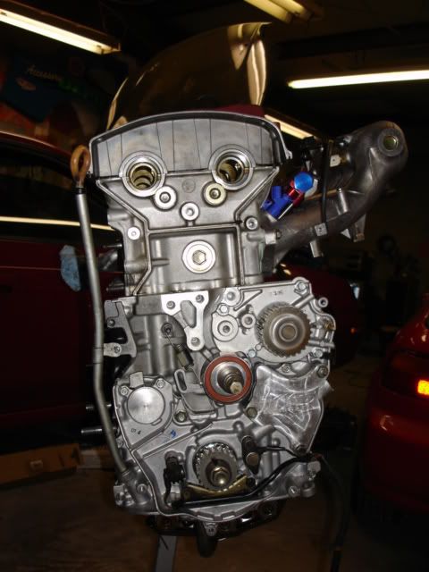

I know you guys like project threads and I hope you guys know that i love learning new things.  Especially when its not everyday you see some idiot trying to run this kind of setup on pump.  Boost is very new to me.  I've always been an all motor kind of guy until i really started looking into the JRSC.  Its basically a wacked out NA platform but with a shitton more torque.  Well i'm going to test this project out with my 89x95 h23vtec.  I've done some modifying to the JRSC already and I have more plans once I can get my hands on a TIG and learn how to do aluminum.
well here are the plans for it and what i currently have
JRSC - sticking to the 5lbs pulley at first
CC head (stock cams and valvetrain)
89x95 h23 block configuration with total static compression of above 13:1 (has a thicker HG)
RMF Narrow header
3" dump exhaust
planning on getting bosch 1000cc injectors and an inline water to air intercooler.  My other plans for keep IAT's sane is to attempt the same type of design that LHT uses, but that will only be able to happen once i get a tig.  So basically having two intercoolers with water running to both.
As it stands right now, NA, the engine makes 215/178 power without the CC head and runs 13.43@104.  I'm hoping I will be able to get this new setup to dip well into the 11's but we will see.  I'm just a college graduate working two jobs in order to make a living and trying to save money to open a shop.  So this will probably take a little time so SHUT THE FUCK UP.
http://www.spankwire.com/Gianna-Michaels-Videos/video150511/
anyway, enough talking and on with some pictures.
^^ after 1500 miles with crower cams and eibach valvetrain from a head i got online.  fortunately I had a spare head!!
that is the gist of it.  I'm currently inspecting and measuring my spare h22a block and crank so i can rebuild it just in case this h23 goes sour with the addition of the JRSC.  That block saw 8500 RPM routinely.  I mic'd the rod journals and all of them are .0001 to .0002 of each other so that made me feel really good and the mains damn near match the OE bearing specs.  I measure the PTW last weekend for cylinder 1 and 2 and both meet the factory clearance.
I'm new to using these kind of tools and getting accurate measurements consistently  i guess is just going to take time and practice.  My PTW went anywhere from .0004 to .0010" all due to taking an average of 5 piston measurements and having one measurement in those 5 that threw everything off.  I'll get better.
more to come in the future.

You think you had the lash too tight, thats the symptoms that I see with rocker pad wear.

upon installation the clearance was in spec.  I ran a few heat cycles and redid the lash and didnt check it again until i pulled the head apart 1500 miles later to do the h23 build.  The valvetrain was a little loud but i figured it was the uber stiff valvetrain.  Its really hard to tell what the problem was.  I dont think the head was in too great of shape.  After i pulled the head off, i noticed a beveled lip around the number 2 combustion chamber like it had been smacked, but there was no other visible damage and the valve seats looked like a typical used head with carbon build up should look like.
This is the dyno with the cams:
then this was the previous dyno with the stock cams when i did the EuroR IM testing
It was just bad from the get go and there are just so many possibilities of what it could have been so i just put it all behind me as a mystery that will never be completely solved.

Had the same thing happen to my shitbox.  Lashj to spec... Ate the exhaust vtec lobes worst (looked JUST like those). I swithched to Royal purple after doing a bunch of reseach about oil additives as a last ditch effort before going roller... 10-12 K later... Perfect.

i had been running mobil1 in the car for i dont know how long.  Switched to Amsoil and was still running that oil when i pulled it apart.  I have no idea if that had anything to do with it but it made me go on a tirade of reading about oil analysis and i now wont run anything but Torco with ZDDP additive.
valvoline vr1 has that zddp shit in it  20w-50  3.99at vato zone  :somb: big cams and hard springs get owned cuz of oiling.. get roller rockers and run cheap oil :noel:

it helps that i got a job at a race shop full of muscle cars.  cant be the guy working there with the slow honda lol.
the shop car is a twin turbo 5.0 stang that runs 8's on pump gas lol.  Cant let these guys have all the fun.
