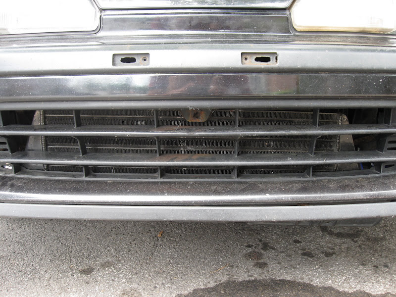

Here are some pics, I have no pics of installation, I had no time for that ;) Video soon, but the gauge only see 4.5psi so its not a monster of power...

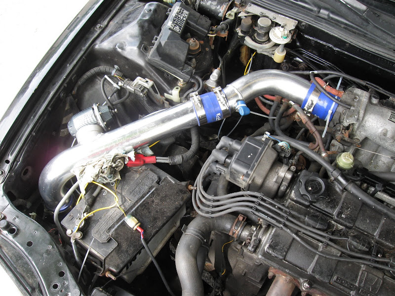

You must have a boost leak some where, soapy water is your friend!

jesus christ those couplers look looser than hotrex's manpussy. spend 4 dollars and get some fucking hose clamps.

I've heard of a small handfull of people who's springs snapped. Overwise it's a VERY torn diaphragm or very bad boost leak. The stock cat is probably melted & plugged, my old EF cat went through melting hell and was stock DPFI til then. Even a fresh stock cat & muffler is too restrictive though.
One easy way to pressure test your hole system, put a plate between the DP & turbo, then cover your turbo inlet & add a valve stem in that plug. You'll obviously loose some pressure past the rings, but you'll find most leaks in the entire piping/intake/exhaust system.

By the looks of those couplings I would say you have a boost leak.

Looks like you have a fat boost leak off ot the turbo charge pipe coupler.

The problem is that ziptie you used on the TB coupler and that hose line you just ziptied, is probably leaking all the boost out. JB weld that hole or cap it with a thick bolt and use a hose clamp.

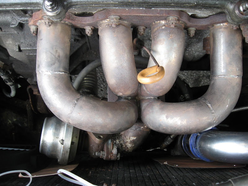

your wastegate is backwards. and lose ALL the zipties probably solve your problem. and i wouldnt turn your boost up until you have all your leaks taken care off. boost leak test it with air (charge the pipe's turbo intake manifold) and use a powder.
wg looks fine to me

You are all wrong wrong wrong wrong. Wastegate is on the good side, no leak in charge pipe.
Like I said in the first post, there was a leak on the turbo/manifold flange. I repaired it and everything is fine now. Boost at 3700 now.

why would you want your wastegate blowing into your engine bay and towards a runner. i understand it may be better than to the radiator but you should have a dump on there too. unless you like the smell of exhaust in your car. and exhaust being sucked back into the turbo.. makes a nice egr i suppose..

I'm restricted with the place because of the big radiator. It was the way I did it last year... I don't know why I put the flange on this side lol
This time I wanted to weld it differently (looking down), but the welder I had suck and I didnt have the time...
