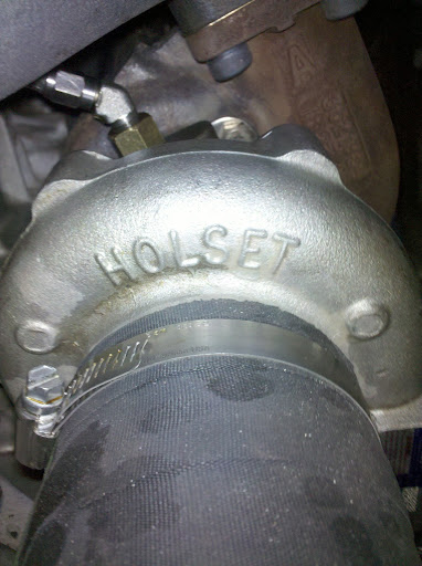

New Setup Added 1/15:
Old Setup:
Tuesday we got intercooler mounted, downpipe made, intercooler pipes almost done, just need to figure out the hot side. We got the oil drain tapped and JB welded in. Just need to get the fuel pump in, injectors in with the pig tails, get my ecu chipped, get the plugs in, royal purple in, vacuum lines for bov, boost gauge, MBC and the vacuum manifold. Should be gettin it tuned in vegas next week hopefully. Anyways on to the pics, shitty ass cell phone pics, but whatever.
Said pics of car and my baller ass downpipe
And that sexy shaved ass
Day Three:
The hot side didnt fit well at all, turbo is almost touching my block. Had to cut the U pipe and put another coupler in the middle, and gangster lean the fuck out of the pipe so it fit.

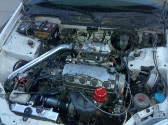

Yes I can quote myself... Anyways went over to my buddies shop and took some pics... Hope your happy jay. Haha.

Re: Dirty D Bitches. Working out kinks.
« Reply #10 on: May 19, 2009, 04:20:40 PM »
Update,
Boost leak problem fixed. The diaphragm on my bov is leaking. With the recirc tube closed, I build boost. I need to cut my cold side and make it shorter, it will rub on my tire if I turn a sharp left.

« Reply #11 on: May 20, 2009, 07:24:17 PM »
Shits done! Boostin 7 pounds! Will have dyno sheet Friday. Hoping for at least 200 whp. We will see.
