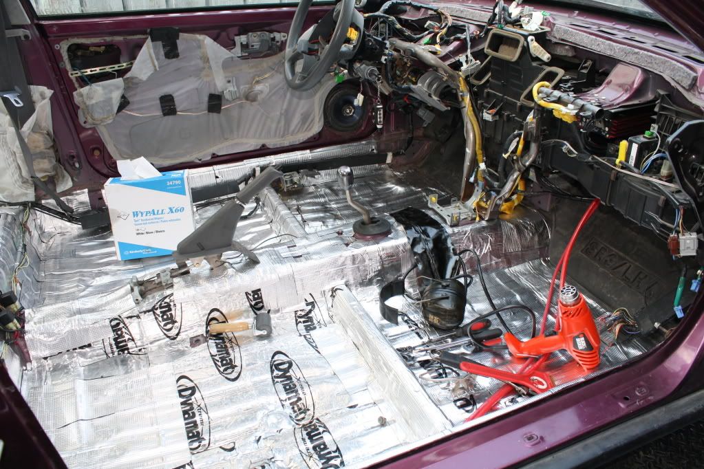

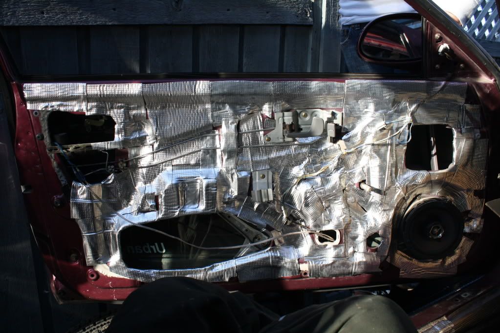

new mod  was some dynamat - I ordered another 100ft box of the b-quiet extreme for the car so I dont have to wear earplugs this year.

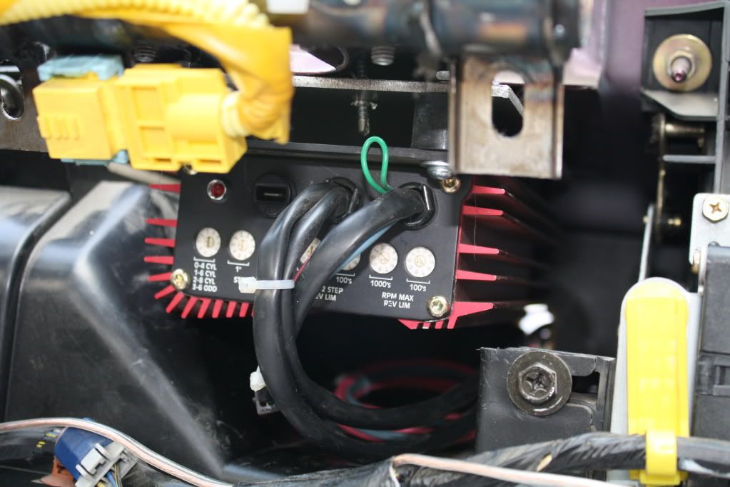

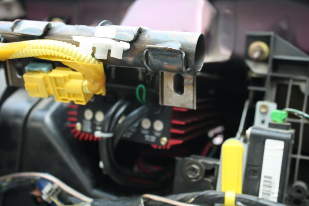

Cleaning up some wiring and mounting the new digital 6 box.
Everything set at 0 except for the rev limiter which I put at 9900rpm for a safety net

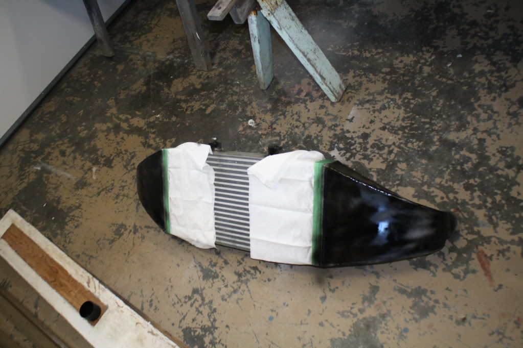

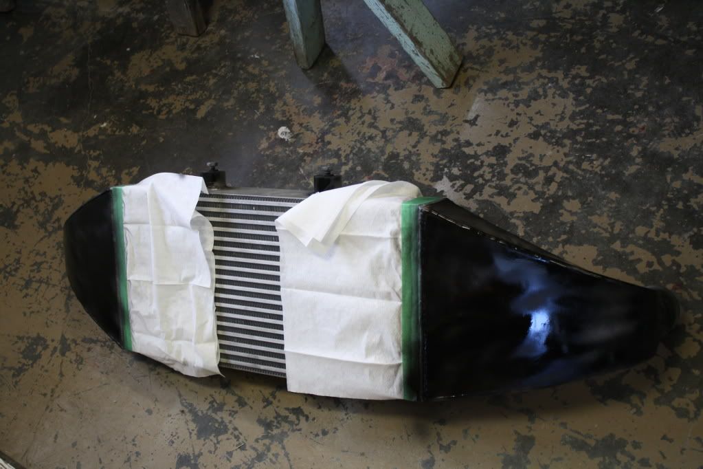

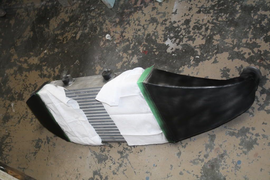

Painting some intercooler so that it doesnt look as tacky. Painted it flat black.

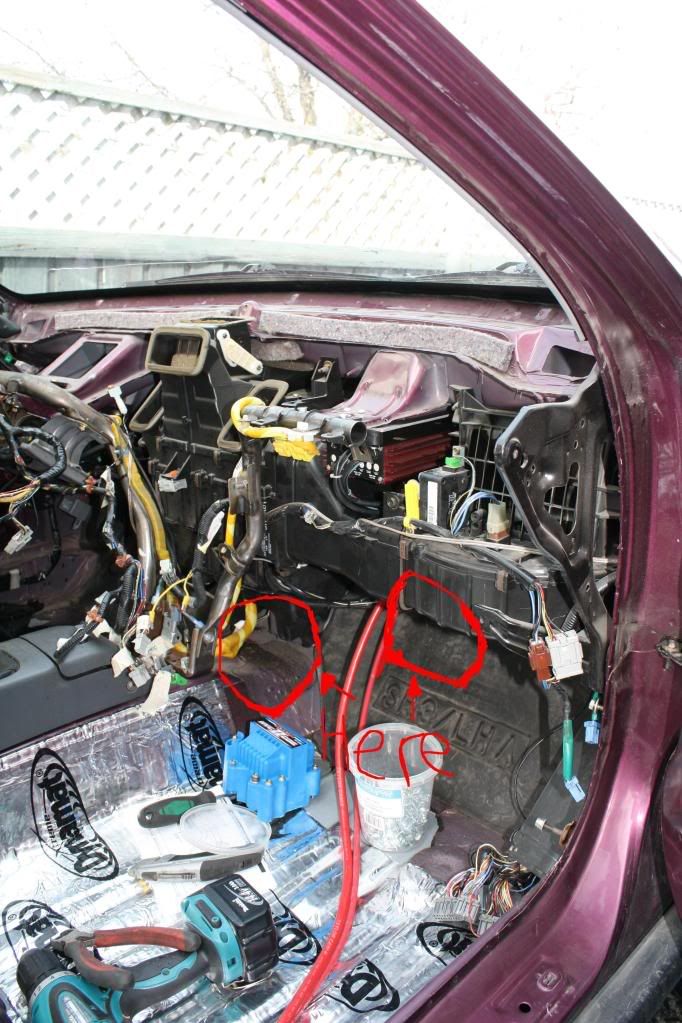

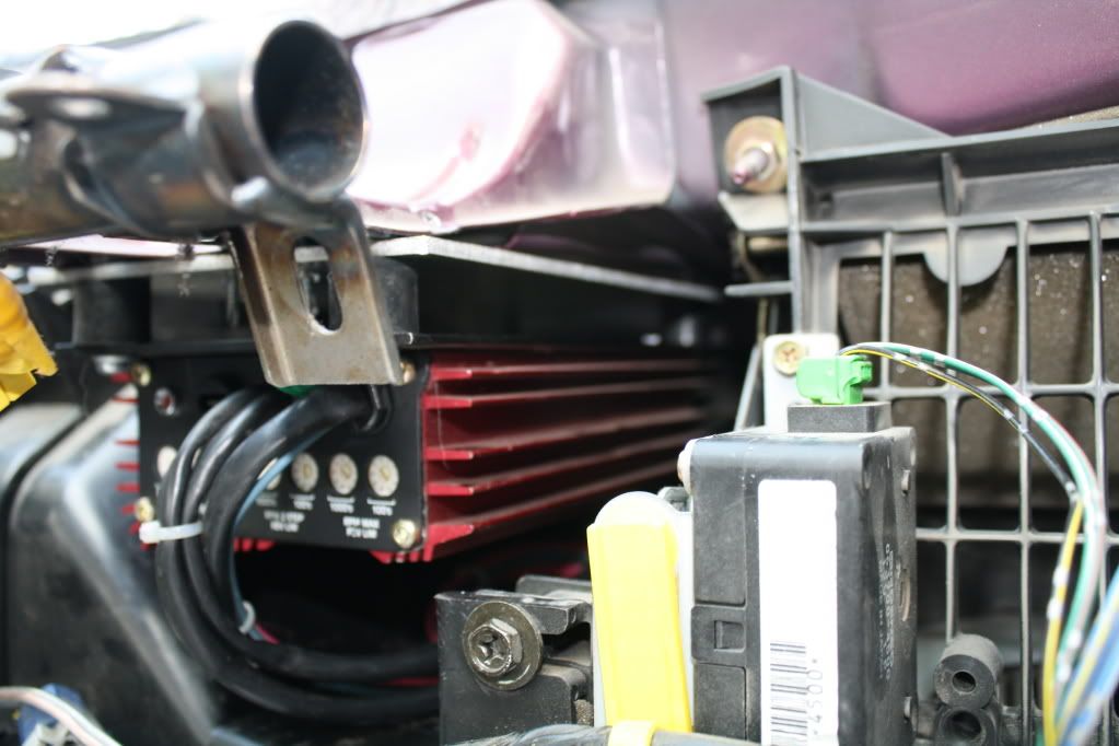

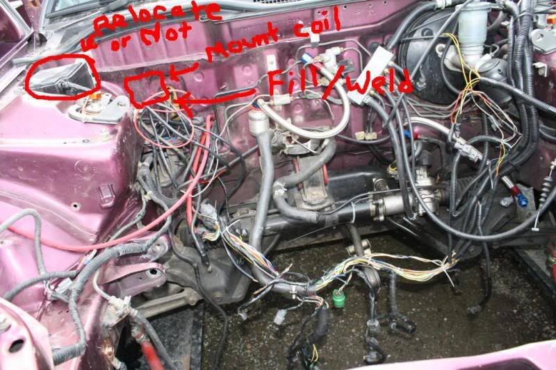

i'm diggin the install location of the msd box, just make sure it doesn't get hot in there or have radio interferance.  coil needs to be mounted at least a a few inches away from the box more is better (also to avoid interference with msd box).
are you lightening the dash at all?  is there going to be access to the msd from your glove box or a ninja style hole of any kind?
[edit]  my vote is mount the coil on the firewall, inside or out whatever works better, inside with a ''through firewall'' adapter would look hella clean from the engine bay.

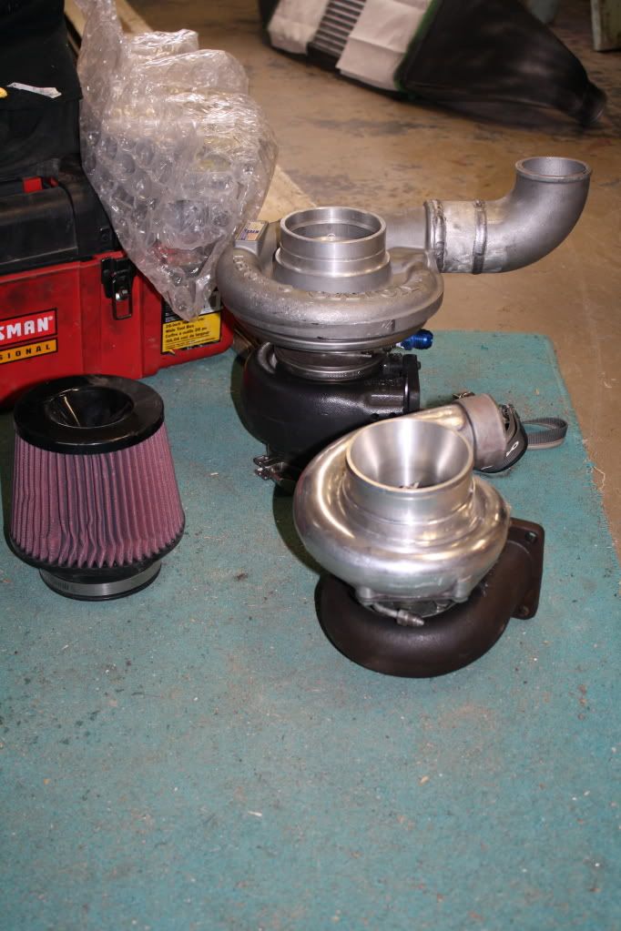

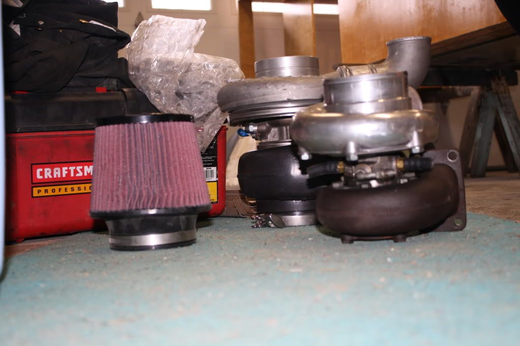

Nice, whats with the 2 turbos?
How much does the dynamat weigh?

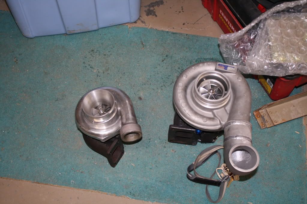

One was the one off my first GSR block then LS setup and now going to highroller The big one is the turbo I am going to use for my car.
and shipping weight on 100ft is 30lbs
yeah I'm with Mathis I like the coils mounted on the firewall in the engine bay.
Now i am trying to figure out where to put this fucking piece of shit. Not alot of room under there you know.

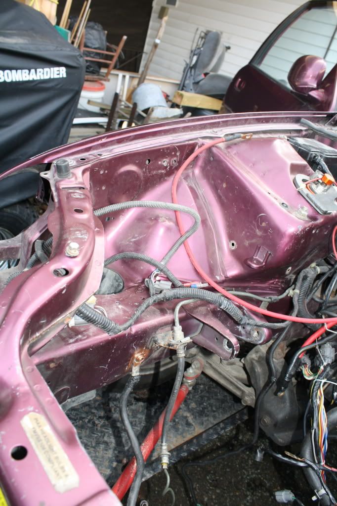

something like this give you an idea?
Re: Urban Indians Re-Rebuild on the HX-52/2.0L GSR
« Reply #14 on: April 21, 2009, 01:07:53 PM »
where is the catchcan going to fit in there? Andy P figures I should put it inside the firewall then run either 1 long wire or 1 M<->M then 1 F<->M connecting at the firewall
« Last Edit: April 21, 2009, 01:27:00 PM by Urban Indian »
trevor72
  • Posts: 467
  • trevwhore
« Reply #15 on: April 21, 2009, 02:03:22 PM »
forgot about that damn box,
if you go inside firewall i'd go with one of these...

I am going to dynamat the car today. pics to follow.
i got one of those msd firewall connectors so I am putting the coin inside the car where it can stay cool.

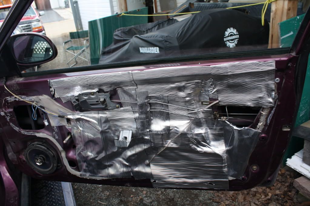

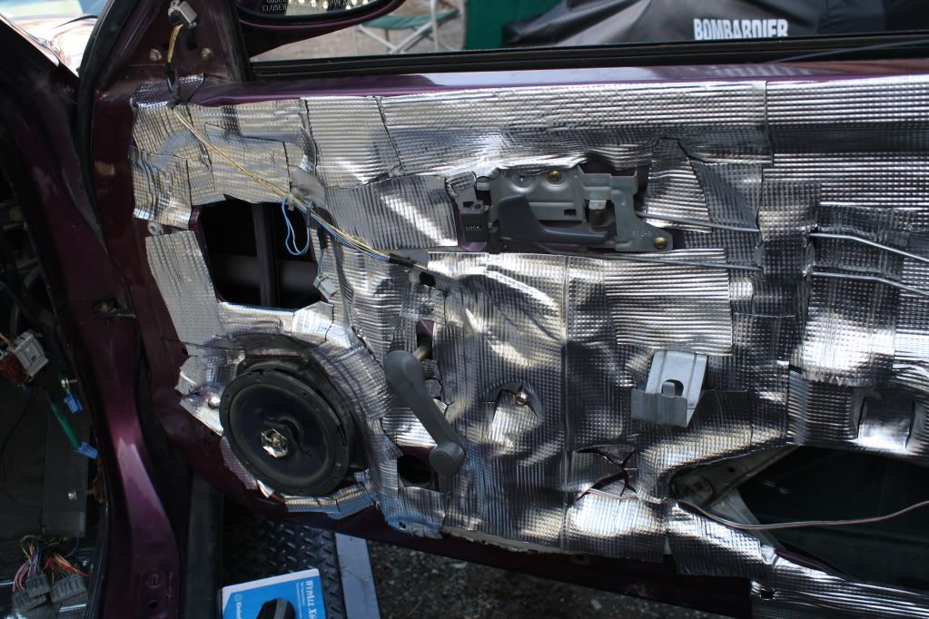

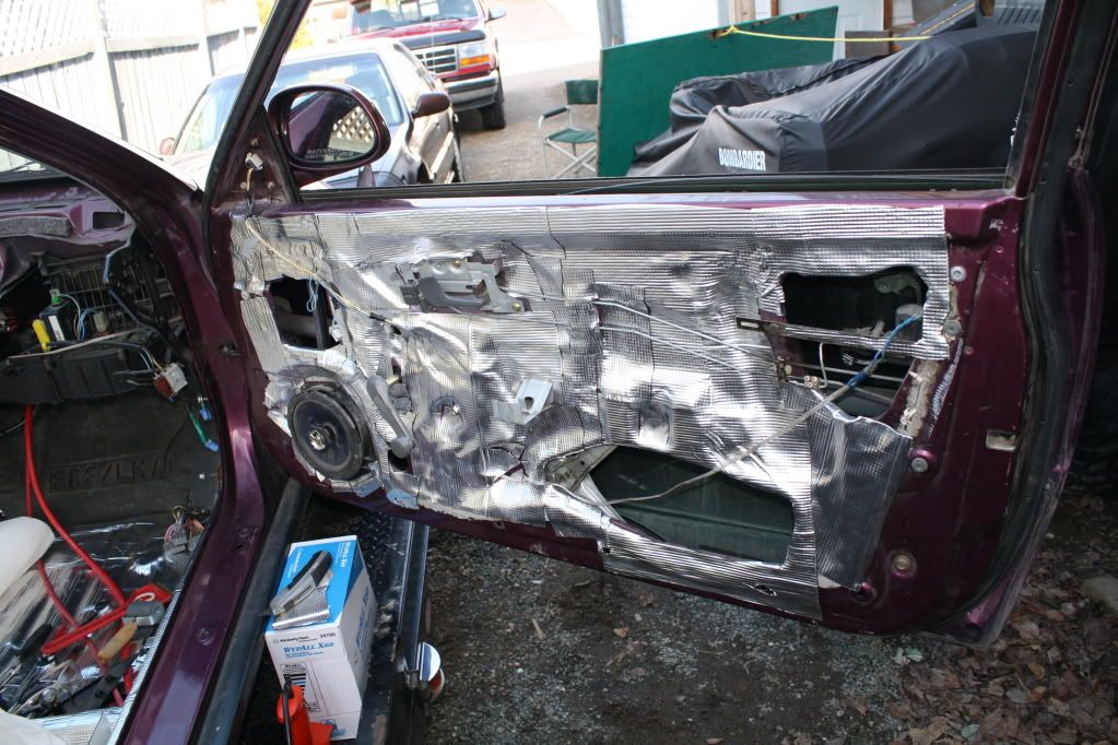

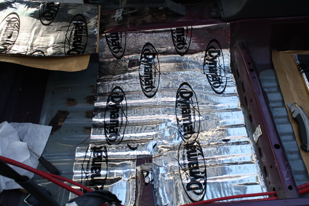

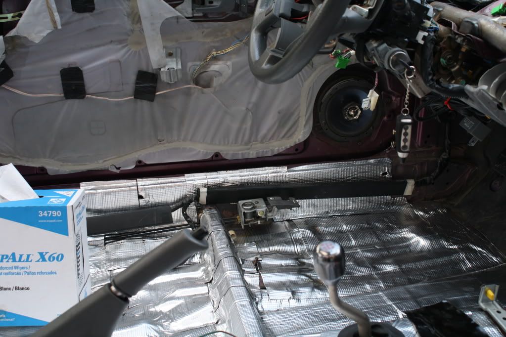

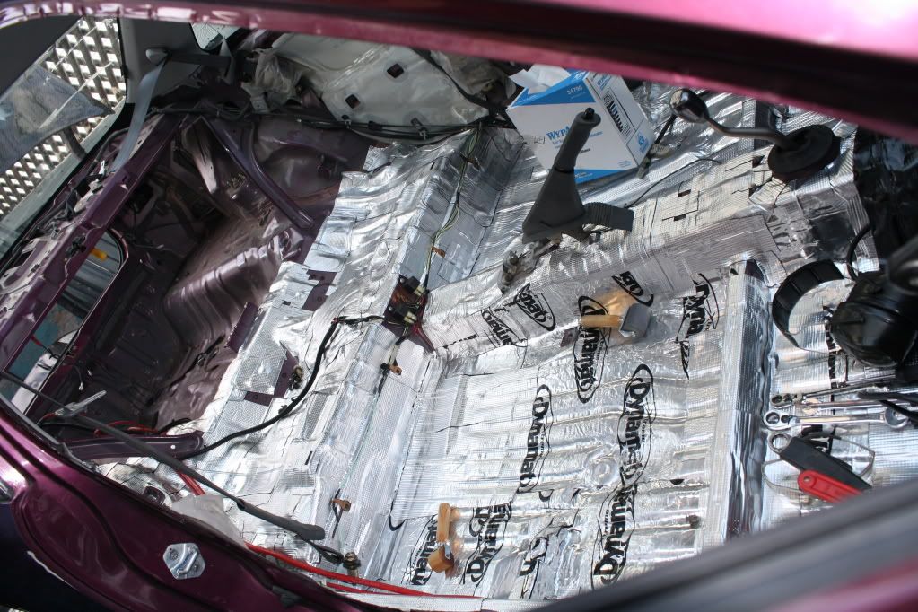

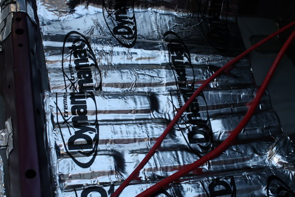

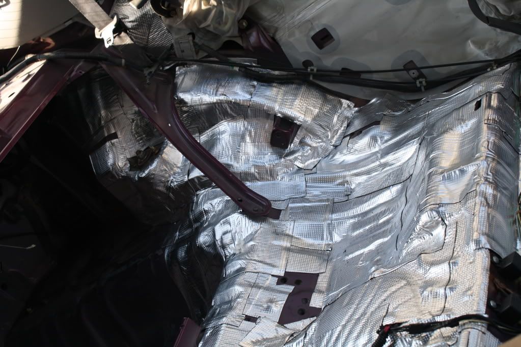

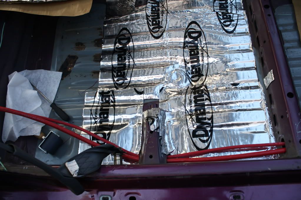

so I ended up using about 60 feet of this stuff. Double & triple layered in some spots. I went overboard but I am scepticle of this stuff actually working. So here you go. Finished the front half with partial trunk and under the foam on the foot(on the firewall) I am done for now.

$500 worth of dynamat
$134US of B-Quiet extreme. That would have been more than $500 of dynamat
Are you planning on driving this a lot on the street? I dont see the point in the dynamat if ur not? Good luck getting it back together hopefully ill see it out at mission if your their.
I drive my car all the time what are you talking about?

ahhh I thought it just sat on the trailer untill it went to the track. If you have full exhaust ull be fine without ear plugs haha
Full exhaust with no interior still required ear plugs in that thing, it was nasty loud. Apparently 4" exhaust doesn't quiet down shit it just moves the exhaust from the downpipe to the back of the car.
